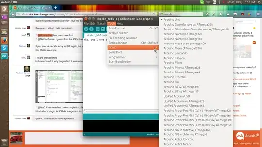

How to I select arduino 101? I have ubuntu. enter image description here
Ubuntu User
  • 133
In that ancient version of the IDE? You don't.
You download and install the latest version of the IDE from the Arduino website, then use the Boards Manager to install the packages that include the Ardiuno 101.
