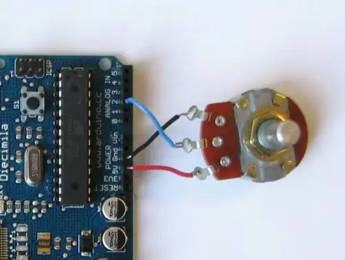

A potentiometer is an analog device, meaning it communicates its position by varying the voltage rather than sending discrete ones and zeros.
If a linear potentiometer is turned half way then the output of the pot will be at half the voltage of the input. If it is turned all the way then the output will equal the input voltage and if it is not turned at all then the output will be 0V.
In order to make sense of the potentiometer you must connect the output to the analog pins and it will give you a 10 bit number, the higher this number the closer the output voltage of the potentiometer is to 5v (or whatever you set the Analog Reference voltage to be, but don't worry about the AREF pin for now).
Digital pins are either on or off, there is no in between, so they do not work for this application

The pot has 3 terminals, so I'm not sure what you mean by that. You are going to connect them to ground, a digital pin, and what else?
Normally you connect one end of the pot to ground, the other end to +5V, and the middle terminal to one of the analog inputs. Then when you turn the pot, the voltage at the analog input changes to be somewhere between 0V and 5V.
A potentiometer is a form of voltage divider - I suggest you read those links to understand more about them.

So yes, you can connect a potentiometer up to to a digital pin in the same way as you can to an analog pin (one pin to +5V, one pin to ground, and the middle "wiper" pin to the digital input):
When you turn it, instead of reading a value between 0 and 1023 as you would on an analog pin, you will either get a HIGH or a LOW depending on how far you have turned the knob and in which direction. In the region in the middle you will read "who knows?" - that is, maybe HIGH, maybe LOW, depending on the weather and the pin itself.
Note that connecting a potentiometer up like this on a pin set to OUTPUT is dangerous (not to you, to the Arduino) and has the potential to damage the GPIO pin's internal circuitry when the pot is turned all the way one way or the other, since it creates a dead short circuit to either ground or +5V, and the GPIO pin itself, when in OUTPUT mode, is also connected internally to either ground or +5V.

If you are trying to read the "value" of the pot, it would work as an on/off switch because this is a digital pin. Digital means 0 or 1. When there is enough voltage, it will register as 1, once the voltage gets low enough, it will register as a zero. If you want to read a full range of values from the pot, you would have to use an analog pin.

Analog pot on digital pin will give, 0:from min to half way and 1: from half way to end position You can use it if this suits your program logic.
