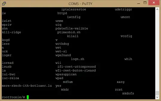

It works for the most part, but has some odd differences from connecting via ssh over wifi.
It seems to be dropping random characters from the screen (due to buffer overflow):
As you can see, it's messed up some of the text such as md5um which should be md5sum and the formatting is all off.

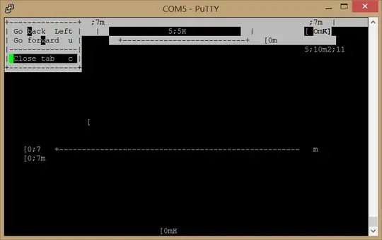

It gets even worse when launching elinks terminal web browser (which works beautifully when connecting via ssh over wifi):
I've also tried different programs (other than putty), including the arduino ide serial monitor, and they all produce the exact same result (and yes I'm setting them to the correct port speed as well).
