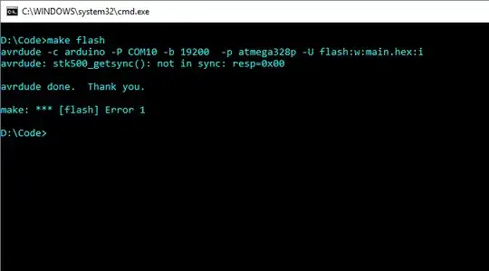

the problem that I have is that when run :
make flash
I get the following :
and yes the port COM10 is definitely correct.
does anyone have a suggestion how to solve this ?
thanks in advance !

There error you have is from avrdude failing to get a communication link established to the 'programmer' (which manipulates the target.)
Here is a link that may help with the connection
Stk500 error
Here is another relative link that may help
Arduino ISP on DUE
Best of luck.
