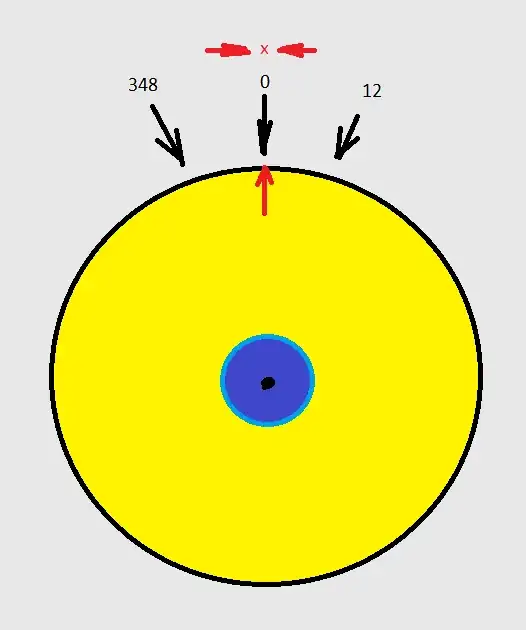

I'm using this incremental rotary encoder with a rotating disc.
Here is my system:
I will explain the system briefly and above is the illustration for that:
The rotary encoder(blue) is attached/fixed to a larger disc(yellow) concentrically at its origin, so both the encoder and the disc rotate together the same angle. The disc is rotating on a fixed plane(gray). The plane has a fixed point mark(red X) on its surface. There is also a fixed red arrow on the disc.
Each time before the system is powered, I will manually rotate the disc such that its red arrow will be aligned to the red X mark on the surface. This adjustment each time at the beginning will provide the reference point.
After this adjustment I want to output the actual angles via Arduino.

But this code increases one count for each encoder tick at CW direction, and decreases one count for each tick at CCW direction. It keeps increasing from zero to 65535 in CW and decrease from 65535 to 0 in CCW. I want to translate this code such that I can output the angle in degrees.
My encoder says its ppr is 15 and 30 ticks. This code increase/decrease one count for each tick.
Any idea how to extract the angle from this setup? (It doesn't have to use the specific code I provided.)
