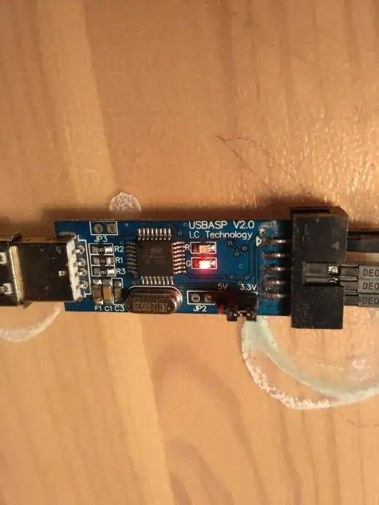

It worked successfully and I recompiled the sketch and upload it with USBasp. I got an error that data cant be verified. It was late in the night so I jumped to Internet and googled it. In one forum I found, post (which I am unable to find again) that stated the he was able to upload sketch when he switched programmer to 5V. (Power was connected to Vcc)
I did that and it worked fine.
Than I tried to make change to sketch and upload it again (on 3,3V) and again got verification error so I unplugged programmer and switched back to 5V.

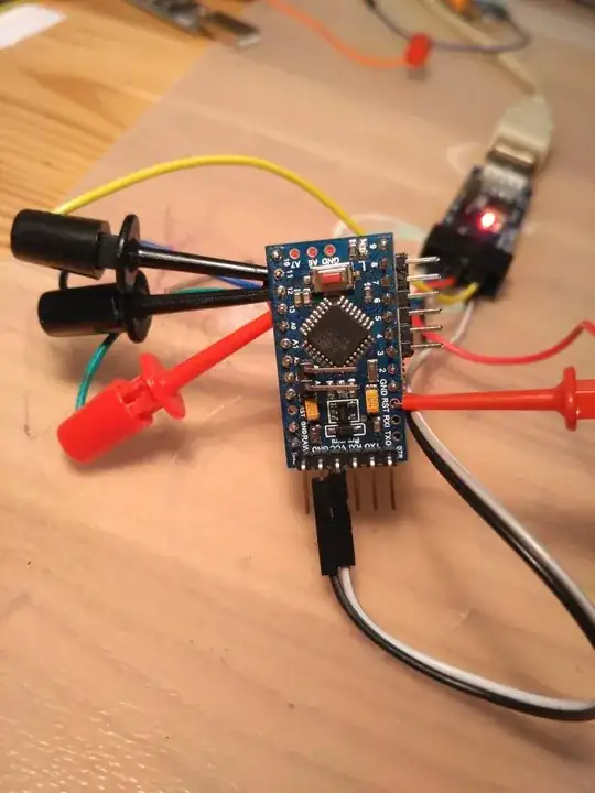

What i did
  1. Checked wiring.
  2. Tried program fuses on blank new arduino - worked (programmer is fine)
  3. Measured voltage ok
  4. Measured current (its around 4mA, I see it as the board is not sleeping and is actively doing something)
  5. I noticed that when I issue command mentioned above the on board led quickly lights up and then goes off again.
  6. I tried to power it from raw, from Vcc and from Vcc on serial hader (picture).
  7. I measured power on Vcc when connected to Raw pin and it reads 3.3V so power regulator should be ok.
  8. I used -B10 switch to averdude with no luck
