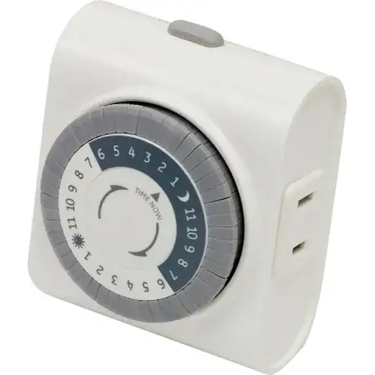

One possibility to consider is to use a 24-hour plug-in timer that controls the power to the Uno.
I.e. something that looks like this:
The circuit would be: AC outlet -> Timer -> USB charger -> Arduino
You could set the timer to turn off the power to the Uno at say 11:30 PM and turn on again on midnight.
Under such setup, millis() will be the time since the last Uno start, which will usually be the time since the previous midnight.
When debugging, you could set the time-at-Uno-start to other than midnight.
The caveats are:
  • Your situation allows for daily 30-minute (or whatever the timer increments are) downtime
  • Can tolerate timer shifts due to power outages
Justas
  • 111
