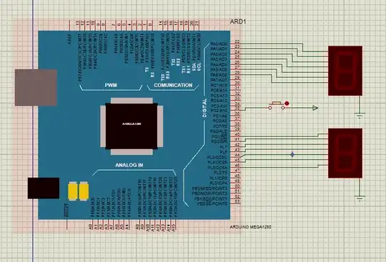

I have a have project of Up Down counter using Arduino with seven segments, in which when I continuously press the push button, the counter moves upward from 0 to 99. When I release the push button, the counter moves downwards from the previous value.
For example: I continuously press the button counter from 0 to 58, then when I release the button, the counter moves backward from 58 to 0.
The problem is that when I simulate the code in Proteus software, the counter starts from 99 because the button is not pressed. But when I press the button the counter moves upward not accurately.
Also the other big issue is that when the button is released, the counter does not move backwards although the counter moves upwards continuously and the button is not working (whether the button is pressed or not).
Here my code and Proteus simulator circuit image.

cirduit diagram of counter
If button pressed ----------> logic goes HIGH If button release ----------> logic goes LOW
Please resolve my problem. I have tried for 2 weeks solving this problem but still I'm stuck. Any little advice will be important for me.
