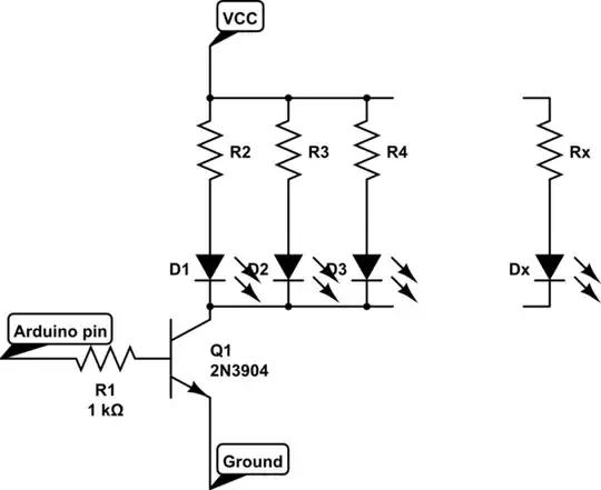

First, since you didn't mention any kind of Arduino, my answer is based on using Arduino Uno/Nano (I think its the most common)
1. Yes you can. You use 1 transistor per building as switch (if there are many LEDs in the building) to gives optimal current and prevent your Arduino pin. The value of R2 -- Rx is depend the LED colour. You can control each group with one Arduino pin.
schematic
