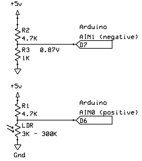

In the event that you want to detect a voltage passing a threshold, rather than being merely HIGH or LOW, you can use the analog comparator. Example sketch:
volatile boolean triggered;
ISR (ANALOG_COMP_vect)

This can be useful for things like light-detectors, where you might need to detect a change from (say) 1V to 2V on an input.
Example circuit:
