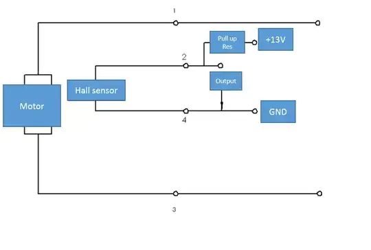

I am working on a project for knowing the position of a DC motor which has a hall sensor built into it. I am a newbie into programming using the Arduino Uno R3. After some forum search and self checks, I cannot pass this hurdle. I hope I can frame the questions properly here.
My Problem: The DC motor hall sensor sends out 2 high pulse of 11.3V - 13V with a duration of 2.8ms for each revolution. My Arduino interrupt pin doesn't read the high pulse as it gives me "0" count after motor spin (I run 50 loops and results remain the same).
Interupt pin asssigment with function call
On my breadboard, I use a voltage divider to reduce hall-effect ouput from max 13V to 5V so that the Arduino pin 2 can read rising voltage when it jumps to 5V (low should be 2.5V).

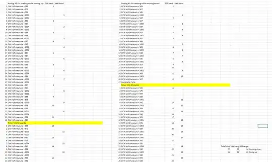

b) The same hall sensor output if connected to analog pin reads 580,590,590,1001, 1012, 580, 580.. etc. I cannot gauge position of the motor by using these values as they are inconsistent on the way up Vs. way down.
I have attached analog readings while going up and down in snap shot below: enter image description here 2 questions I have:

Check: 1. Hall sensor connected to Pin 2
  1. pulses variable declared as volatile.
  2. Check if internal pull up resistor setup consistent with hall sensor connection.
  3. Check that Hall sensor's lowest signal voltage is below 0.3 VCC (you said 5V, so it should drop below 1.5V), BTW 580 - the lowest analog value you showed means 2.83V

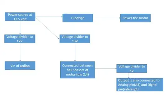

General block diagram
Motor with Hall sensor, Ve is 13V, Ue is 13.5V:
I print the counter (Analog pin) and pulses (interrupt pin) with running this program code.

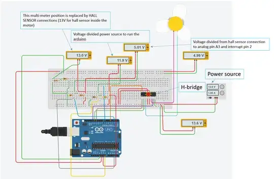

I tried modifying the voltages to interrupt pins
Now interrupt pin voltages read: High:1.456V Low: 1.07V
Note: The arduino is running at 12V external source.
My "pulses" counter still reads 0 for interrupts. Any idea why?

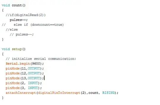

anuzarduino
All,
My Arduino is not reading interrupts across the interrupt pin:
I am getting a high of 1.456V and a low 1.07V through the interrupt pin 2... But the pulses counter still remain 0....
Any idea why?

All,
I didnt need the voltage comparator in the end, the code was running slower and wasnt picking up all the hall sensor signals that the motor was giving due to loop time. i changed the ifs to else ifs and then i was able to get a faster loop time.
Thanks all for the help.
The device is working as intended..
