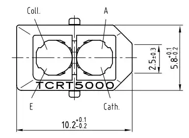

    Note that the two hemispherical plastic parts of the TCRT5000 look more or less the same, so you will have to identify which one is the detector, and ensure that you do not obstruct the emitter by mistake. The side with the angled vertical edges (right side of image below) is the emitter and must not be obstructed.
TCRT5000
With this arrangement, the collector current through detector will dip significantly each time the black stripe passes in front of the detector.
