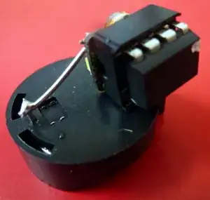

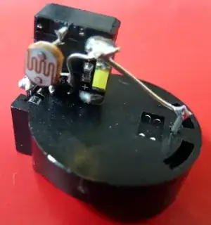

I made up a small torch locator which used an ATtiny85 powered from a button-cell (CR2032). It looks like this:
Torch locator
Other side:
Other side
That currently weighs 5.9g. The battery-holder weighs 1.6g so you could save that by making a more light-weight holder (perhaps a bit of plastic for insulation, and soldering directly to the battery). The chip socket weighs at least 0.5g, so you could save that as well by soldering to the processor pins. So we are down to 3.8g.
The ATtiny85 has 512 bytes of EEPROM which you could use to log readings to. I'm not sure about a clock if you are trying to save weight, but if you start it at a known time, you could have a reasonable estimate of the time by using the millis() function to find miliiseconds since startup.

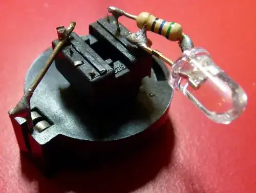

I made another one a while ago which flashes an LED every couple of seconds:
LED flasher
That is similar. The processor is there (upside down under the chip socket) and the battery is underneath. That weighs 6g. The battery has lasted a couple of years, and that is flashing an LED every couple of seconds!
Instead of the LED you could have a thermistor to read the temperature.
You could program it to take a reading every few hours and save it to EEPROM. Then when instructed (eg. by joining a couple of pins) it could output the readings to another pin (via serial).
You could save more weight by using SMD (surface mounted) devices, and perhaps using a tiny circuit board you could get made up.

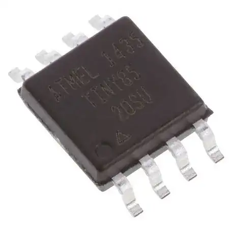

I would personnaly suggest an ATtiny 45/85. It is pretty much a small AVR with 5 GPIOs. You can program it with the Arduino IDE and use the Arduino as ISP. If you can design you own custom PCB, a SMD version of the ATtiny is small, low and compact. The total circuit to make the ATtiny function is also minimal.
Also, at a low clock speed (0-4MHz), you can power the ATtiny at a voltage as low as 1.8V. You could probably even run it at 1.5V, but this is not totally recommended. If you want to be safe, a 3V coin cell will be small, flat, and it can last probably many years. It is also a little safer compared to lipos which have many risk, especially if you mount it on an animal that you can't really control.
I would also recommend SMD components if possible. It lets all the component be lower and it doesn't hurt or sratch the skin of the person/animal you are monitoring.
