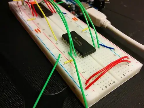

IMG_20140624_225046
^^ You can see the big honking button in the bottom right. It is connected to 5V and then the MUX pin.

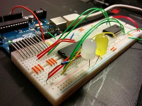

IMG_20140624_225054
^^ I have two multiplexers. The one on the left is for the LEDs and the one on the right is for the buttons (of which I currently [ha!] have only one).

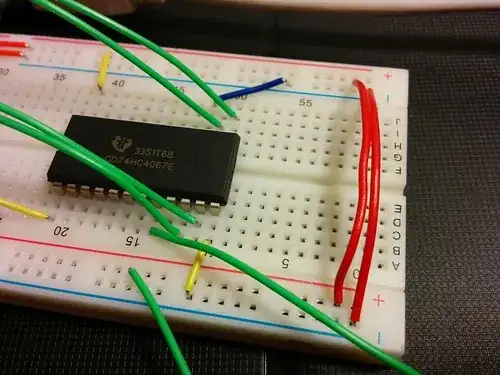

IMG_20140624_225113

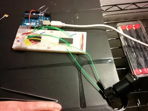

IMG_20140624_225123

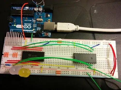

IMG_20140624_225136

All your unused MUX input pins for the button MUX are floating. You will need to tie all of the unused inputs (those that do not have a physical button attached) to ground. Floating inputs are undefined and cause undefined output.
Also, when your attached button is not pressed, its input will also be floating. You can avoid this by connecting the input pin on the MUX to ground using a resistor. That way, when the button is not pressed the input will be low (through the resistor), and when the button is pressed it will be high (through the button connection).
