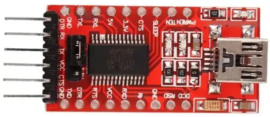

The usual USB-TTL FTDI breakout board looks like this:
USB-TTL FTDI Breakout board

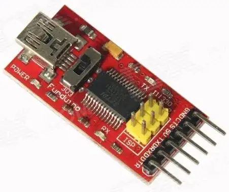

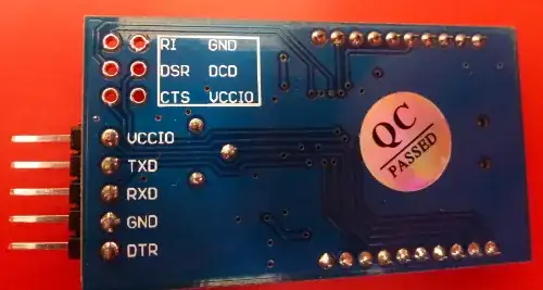

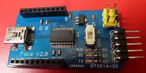

Recently, I came across a variant of the board shown below. However, what are the additional yellow header pins on this board for? They are labelled ISP.
USB-TTL FTDI Breakout board with ISP
Here is a view of the rear:
USB-TTL FTDI Breakout board with ISP rear

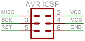

So can they really be used as a standard ISP/ICSP?

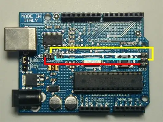

AVR-ICSP

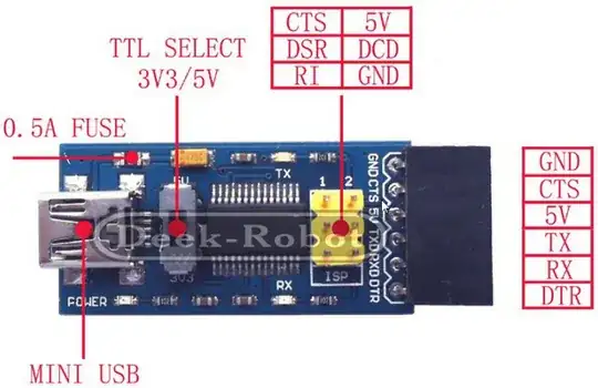

However, according to the diagram below, which labels the 6 pins in question, I am not sure that there is a valid correlation of signal lines.
USB-TTL FTDI Breakout board with ISP with legend

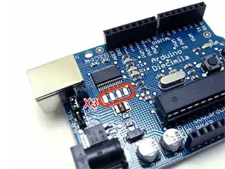

It is also said, in post #7, that these pins are actually equivalent to an X3 connector, as found on the older Arduino Dicimila/NG/Duemilanove boards.
X3 header on Diecimila
and those can (evidently) be used like so, as a bit banged SPI,
Connecting X3 header to ISP header on Diecimila
It should be noted that the RI, CTS, DCD and DSR (labelled RSD) pins are available, along the sides of the original FTDI breakout board. So, does the breakout board with the ISP header just provide access to these same signals using a different header?
I am a little confused - have I just over thought this, and this breakout board is simply an ISP/ICSP header and an FTDI connector rolled into one board (when used with the appropriate version of avrdude)? Or is it not a usual ISP header? I can not find any specific documentation relating to this type of breakout board, as stated in post #4.
Can anyone say, definitively, what these six pins are for? If they are not a normal ISP header, could you provide a detailed way of using it? A schematic would be helpful.

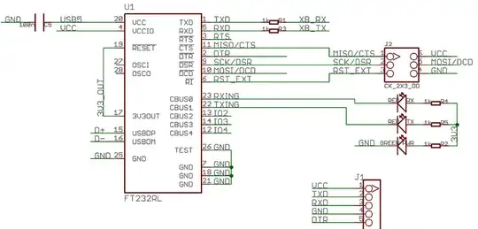

I found a schematic (below) which is not for that board, however the header pins are labelled the same as you found, so it is plausibly similar.
FTDI board schematic
It appears that header is used for "Synchronous Bit Bang mode" as documented here: Bit Bang Modes For The FT232R and FT245R (Application Note AN_232R-01, Document Reference No.: FT_000339)

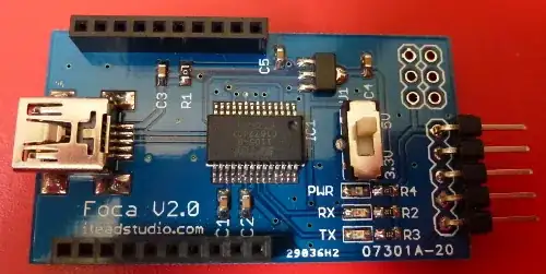

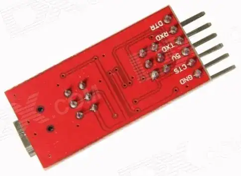

I made up a test as I had a similar board in my parts drawer:
FTDI board front
It had provision for a 6-pin header similar to yours. Turning the board over we can see that they were labelled exactly the same as yours:
FTDI board back
I soldered on a header (in yellow, to be consistent) giving me this:
FTDI board with header
I added a white dot to indicate pin 1 (visible on the edge) so I plug the cable in the right way around.

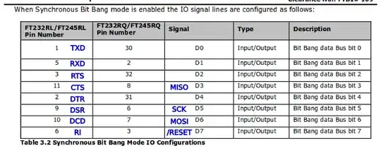

The mapping of pins to numbers works like this... From the PDF about bit bang mode mentioned above we have this table, with annotations in blue by me:
Bit bang mode pins
The numbers refer to the bit number (i.e. in the range 0 to 7) in the "bit banged" data byte. We can see from the earlier schematic that, for example, MISO on the ICSP header is wired to CTS on the FT232RL. Thus MISO is data bit 3, which we tell avrdude in the above configuration. Similarly SCK is data bit 5, and so on.

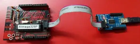

Example connected to a Diavolino
Programming an Atmega328P
Once we have got this far you just connect the FTDI board to your target board with a straight-through cable.

The FTDI board you have (and the one I have) can be used as a ICSP programmer for the AVR chips, as described above. Thus a simple board can be both a USB to serial converter, and also an ICSP programmer.
I see similar boards selling on eBay for around $5 so that is probably quite a cheap programming option.
