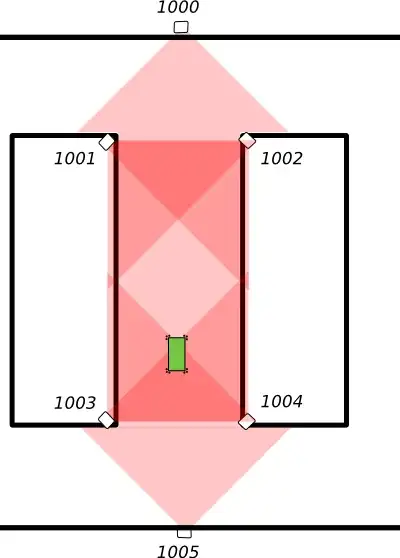

I'm going to get a bit ambitious here and suggest something along the lines of what the Vive virtual reality system uses. You can see from some of the photos on that site that the headset has lots of sensors on it. Judging by this article they detect signals from two base stations. I presume the base stations send IR beams (because radio would not be directional enough). The sensors on the headset are recessed a bit, which would shield them from anything but a line-of-sight beam from a base station.
The store
Now you don't need anything quite that sophisticated, but something like this might work. First, you have some IR transmitters located around the store, pointing in a criss-cross pattern, like this:
Shopping trolley system
The green box is the cart and the bigger boxes the shelving. Now with sensors on the corners of the trolley, pointing in different directions, and with each transmitter sending a differently-coded IR beam, the trolley should be able to work out its position fairly accurately.
The trolley
By a process of exclusion (if you don't see a particular base station then you are not near it) and inclusion (if you do see a base station from a certain sensor then you can deduce a possible area you are in) you should be able to work out your position.
In this case we might expect that the bottom-left-diagonal sensor would be picking up signals from station 1003, and the bottom-right-diagonal sensor would be picking up signals from station 1004. Plus the forward sensor may be getting signals from station 1000 (depending on the range) and the rear sensor from station 1005.
The shopper
Now we also need to know where the shopper is. If you gave the shopper a vest or belt with sensors on it in a similar way (eg. front, back, diagonal) then similar calculations can work out where the shopper is. Let's assume that each shopper and each trolley are given a unique ID pair (that is, a trolley is associated with a vest). Effectively, each shopper would transmit, every second or so "shopper 5677 is at position x=543, y=666 in the store".
Now we can use radio transmission (from the shopper) to its paired trolley, to tell the trolley where its "owner" is. And assuming the trolley knows where it is, then it can work out if movement is required, and if so, in what direction.
