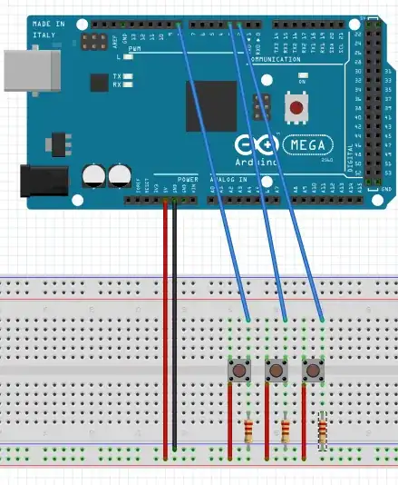

I made a part of code to change the temperature limit for alarm system. On warm days user have to change the temperature limit with buttons and OLED display.
The question is: How can the variable templimit keep its last setup value after many restarts(for many reasons)?

This is the schematic

An Arduino Uno has 512 bytes of non-volitile memory called EEPROM or Electrically Erasable Programmable Read Only Memory. Other Arduino platforms might have more. Accessing it is complex. Fortunately there is an Arduino EEPROM library already written for you. Your value is stored in a type int so I would use the read() and update() methods in the EEPROM library. The read is self explanatory. But the update, unlike the write, only runs if what is in the EEPROM location is different from what you want to write. In this way we save the EEPROM a little bit of ware and tare. As EEPROMs usually have a finite number of write cycles until they start failing. Which usually is in the tens of thousands.
st2000
  • 7,513
The microcontroller on the Arduino MEGA boards have 1024 bytes of EEPROM: memory whose values are kept when the board is turned off (like a tiny hard drive). These values will stay in the EEPROM when the board is turned off and may be retrieved later by another sketch.
I wrote two read/write functions if the value you want to write on EEPROM is negative because temperature has negative values too. Arduino EERROM write word with values between 0-255, also, has a lifetime 100,000 write cycle/ cell.
You can use EEPROM.update(address, value) instead of EEPROM.write(address, value) so the value is written only if differs from the one already saved at the same address.
Save to EEPROM:
void save_to_eeprom(unsigned int address, float config) { // (address, value)
  for (byte i = 0; i < sizeof(config); i++) { // size of config is 4
    EEPROM.write(address + i, reinterpret_cast<byte*>(&config)[i]);
Read from EEPROM:
float read_from_eeprom(unsigned int address) { //(address)
  float config;
    reinterpret_cast<byte*>(&config)[i] = EEPROM.read(address + i);
  return config;
This is how templimit will keep its last value after restart, the full code is:
