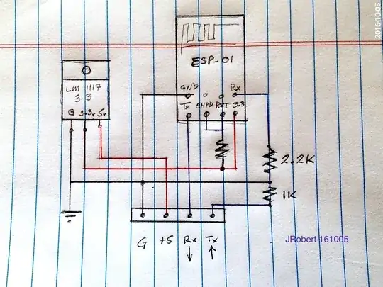

Update: I use the ESP8266 like the one you linked to. They're cheap and easy to use but with a gotcha: they are 3.3v only on both power & signal lines, which can be a challenge when working with a 5v MCU board. Here's how to wire one up for a 5v Arduino. Note the dedicated 3.3v regulator; the Arduino's on-board 3.3v supply isn't sufficient for an ESP8266:

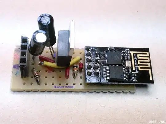

For quick & dirty, you can wire this up on a breadboard. Ultimately you'll want something more stable (mechanically) than breadboard wiring. I made up a few 5v ESPs on strip-board (aka Vector board or Vero board), but that's another project:
