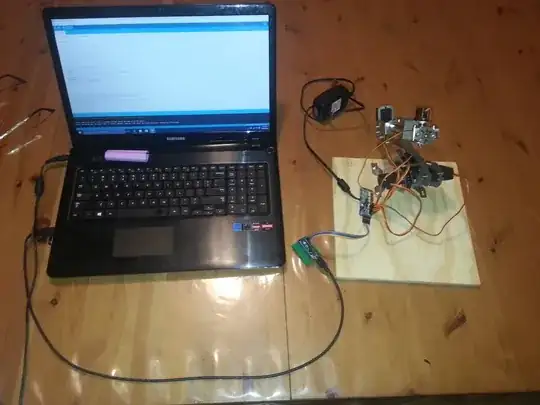

My 10-year-old son went to a "Robotics Camp" and came home with a non-functional Arduino robot. I figured it shouldn't be too much trouble to get it working. He swears he had it operating at the camp, but our best efforts notwithstanding, we were unable to reproduce his successes at home to any degree at all. Currently we seem to have an ungainly, $400 paperweight.
I'm a .Net web-developer by day, but I'm completely uninitiated when it comes to Arduino. I did enough research to learn how to upload a basic sketch- the "Blink" sketch- to our board an verify that the board is functional. Upon uploading the Blink sketch we got a flashing red LED. I was able to go into the sketch and modify the the variable values and see the results in the duration of the LED flash after uploading the sketch again. So I'm confident that we have a good connection to the PC and a functioning Arduino board.

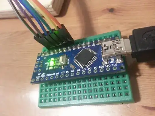

But beyond that I'm stumped. When I attempt to upload the program that my son brought home, the robot does nothing. I can see a red LED blink a few times on the Arduino, but other that that, nothing happens.
Here's some photos of our setup:

I'm not familiar with the breadboard in your images. You didn't mention if you're familiar with how to use a breadboard and from what I can see I'm not even sure why its being used. It looks to me like you could just connect the jumper wires directly to the pins on the Arduino.
Was the Arduino ever unplugged from the breadboard after it was known to work properly?
Due to the angle of the photo it is hard to see which pins the wires are connected to. Can you identify which Arduino pins the six wires are connected to?
linhartr22
