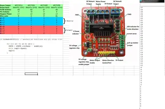

In order to clarify, please see the image below:

void motorR(){
  int bitMask=B00001111; // bitmask to modify only last 4 bit
          for (int id = 0; id <4; id++) {
            PORTB = (PORTB &~bitMask) |  modeR[id];
            while (tmp2++<Speed);
            tmp2=0;
void motorF(){
            PORTB = (PORTB &~bitMask) |  modeF[id];
            tmp2=0;
