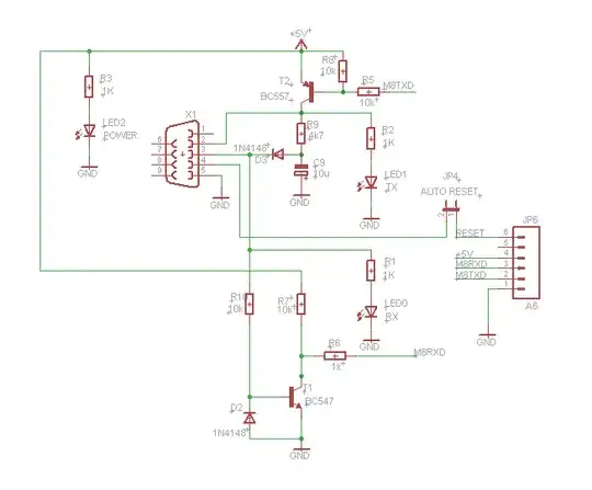

I upload sketches to it using a RS232-to-TTL adapter that I've also built (schematics also below) and a Serial-to-USB cable. When programming it, the board behaves much like a Severino board.

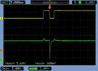

I finally found what was causing the problem: the reset signal from pin 4 (DTR - Data Terminal Ready) on the DB9-Female connector was spiking up to 10V before going to 0V and was triggering high-voltage programming on the ATmega. Below is a scope shot showing the situation:
Scope shot showing voltage spike to 10V
The yellow trace is DTR signal while the green trace is the RESET signal on the ATmega.

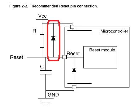

According to Atmel's Atmel AVR042: AVR Hardware Design Considerations application note, one should add an ESD diode between ATmega's RESET and Vcc to prevent the reset signal from triggering high-voltage programming mode, like so:
Recommended RESET pin connection for ATmegas

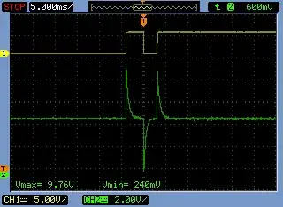

After adding such a small signal diode (1N4148) like the app note recommended, I got the issue fixed. See below the scope shot taken after the diode was added.
Scope shot after fixing the board
Now the 10V peak is gone.

I'm not sure but the problem may also be related to the auto-reset feature of the converter board.
I copied the converter board design from the Arduino Severino and according to its manual, the serial communication must be set to 19,200 bps for the auto-reset feature to work.
Be sure that computer COM Port speed is set to 19200bps otherwise auto reset will not work properly.
Well, I'm using 115,200, so that must be a problem.
