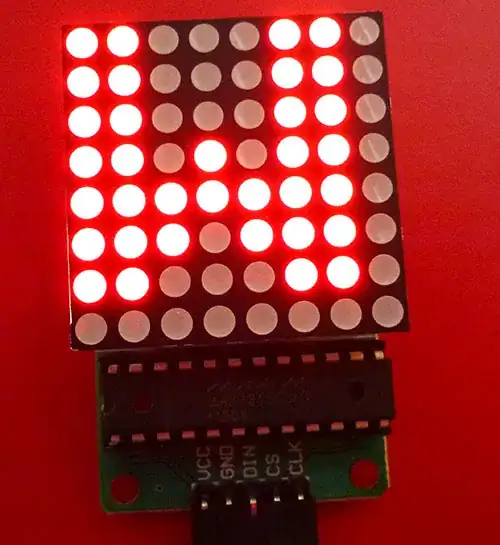

The other answers give great suggestions, but to add to them you could consider the MAX7219 driver chip. I have a page about using it. It can drive a 8x8 pixel display (like one alphanumeric character) or 8 x 7-segments displays (a 7-segment display usually has a decimal place so that is really an 8-LED display).
Example of 64-pixel display:
64 pixel display

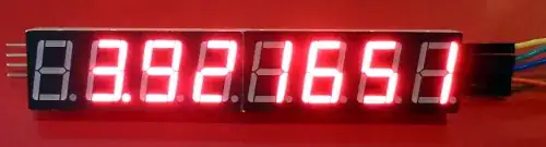

Example of 8 x 7-segment displays:
Those displays come as a unit (2 x 4 digits) but there is nothing stopping you running wires to individual 1-digit displays if you want to.

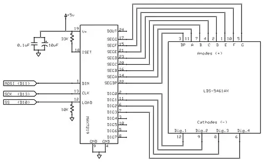

Here is a possible schematic:
MAX7219 schematic
If you are running to individual displays you just parallel-up the anodes (A to G, plus DP) and run a "digit" line to the cathode of each display.
That will only take 3 signals from your processor (MOSI, SCK, SS) plus power and ground.
I notice you are talking about 16-segment displays and not 8-segment displays, but the chip allows any bit patterns to be sent out, so you could consider a 16-segment display to be the same as 2 x 8-segment displays. You would just have to make up a suitable bit-pattern to show each digit.
The MAX7219 also handles the requirement for constant-current driving of the LEDs.
