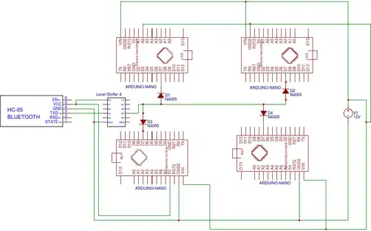

The track has 3 rails, 12V, Ground and Signal and all Arduinos share the same rails. Hopefully the schematic below does a good job explaining it.
Arduinos all share common ground, 12v and data line
On to my issue. Initially, I was getting almost 5V from my pin 7 (SoftwareSerial pin) on the Arduinos, which was quietly ruining the TX pin on my HC-05. I lowered that to about 1v after using pinMode(bluetoothTx, INPUT);, which is good but not good enough. That voltage starts to add up as I add more and more Arduinos to the overall setup.
My solution in theory is to add diodes to pin 7 on the Arduinos, so they can't put voltage on the signal rail. This drops the voltage by 0.7v from what I've read, which most likely is why the Arduinos aren't reading a signal now, because that drops it below the logic level required, since the HC-05 is only putting out 3v3. So I think to add a level shifter on the HC-05 to pump up the signal to 5v, then the diode's voltage drop shouldn't matter right? See schematic below.
Diode's keep pins from leaking voltage onto line, level shifter compensates for voltage drop over diode
My solution seems unnecessarily convoluted and I don't even know if it would work. The more I read without bouncing the information off of others, the more confused I am becoming. Now after reformatting this post for an hour, I am thinking about a decoupling capacitor between the pin and ground... Will that have the effect I am looking for?
I also looked into using a pulldown resistor, but from everything I've seen (and from the first electronics course I've taken), it seems like an inappropriate solution. The examples I've seen usually use a switch, which makes sense, but for my application I am protecting the TX pin on my HC-05, so I think it would not give the effect I am looking for (tapping the line in between resistor and pin would not isolate the voltage, tapping in after the resistor would short the signal to ground).
I'm including my code for completeness, but the schematic is where I think I need help. Could someone point me in the right direction, I don't mind working for my answers but I've been going solo at this for over a month now, and I'm not even at the point in my education where we've covered much logic yet. I'm reaching a little here.

first of all just to clarify some things.
softwareSerial library sets PinMode for rx,tx declared pins internally so it should not have any impact on voltages you measure if you include pinMode(bluetoothTx, INPUT); and if this happens, as you describe, it indicates a problem.
a pin declared as INPUT is on a high impedance state which means that it will not (in general) affect signals connected to it.
an RX pin, by default is pulled up which means that when you do not have anything connected to it, you should measure 5V and when you connect it to GND you should read 0V.
i tried to reproduce your problem by implementing your first schematic utilizing 3 arduinos as receivers with the difference of having another arduino as transmitter instead of HC-05 and using a simplified version of your program (see it below). I could not reproduce it. Also, I suspect that parallel pull up resistors from ~8 arduinos may be the problem, so I would suggest:
  • make sure communication between HC-05 and only one arduino works.
  • try connecting HC-05 with two arduinos and see if both arduinos are able to read incoming data.
  • keep adding arduinos and checking if every arduino can read incoming data.
also try with another arduino as transmitter instead of HC-05 in case you still have a problem and post the results so we can further investigate .
