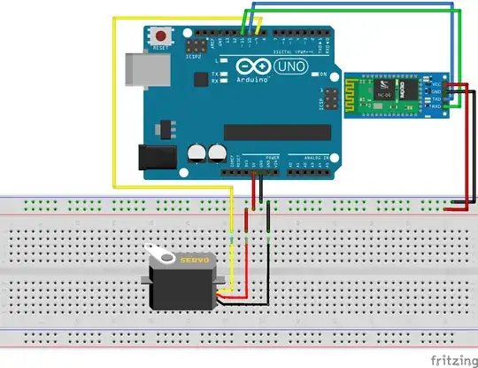

  1. I used Nexus 5X and apk app to pair with HC-06. It pairs well at the first time of connection, but it loose connection after servo moved once. Application said it is connected with bluetooth, but HC-06's LED is blinking(which means disconnected). How can I maintain connection with HC-06?
This is my board. arduino board image
And I made apk app using MIT App Inventor 2.

  2. but it loose connection after servo moved once
    I think your servo is drawing too much current from Arduino Board which results in a drop in net voltage. And hence your HC-05 (kind of) tuns off. This is what happens most of the time.
