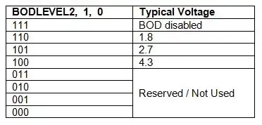

It was a brownout fuse problem.
Changing boards.txt from:
atmega328bb.bootloader.extended_fuses=0x05
to
atmega328bb.bootloader.extended_fuses=0x02
solved it for me (*).
The chip and red LED now work at 3.01V (1xAA alkaline and 1xAA rechargeable) and 3.19V (2xAA alkaline).
(*) not sure why I had to invert the bits (0000 0010=0x02 versus 0000 0101=0x05) when compared to the tables below.

Hy all,
I´m facing the same issue. Had an ATMEGA328P-PU with 8Mhz Oscillator on a breadboard that did not work with 3.3V (stabilized) as a supply. At 5V things work as expected.
Finally I got things running with extended fuses set to xxxxx110, which sets BOD to 1.8V. I coud verify that my ATMEGA328P-PU does not run with fuses set to xxxxx101 = 2,7V (max. 2.9V). The supply is about 3.4V and has blocking condensators, so it cannot be a supply issue.
Best regards, Eckehard
