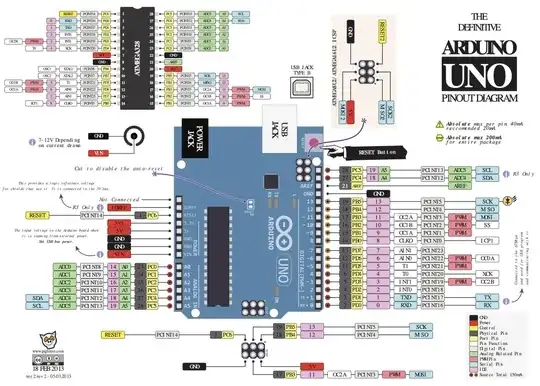

The Arduino Uno is little more than an ATmega328P microcontroller. In most cases you will be interested by the documentation of the microcontroller itself. Anyway, here are both:
Alberto (aka PighiXXX) has published nicer versions of the Arduino Uno pinout:
