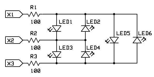

If you have a Charliplexing board like mine (or even if you made your own) the problem could be electrical. If you turn on a lot of LEDs you may exceed the current consumption allowed and then the processor hangs or resets.
I suggest current-limiting resistors like this:

First thing to do is find out whether your problem is electrical or not.
This can be done by removing the electrical parts not crucial to run the code.
If the problem is code related try using another board to eliminate some hardware malfunction on your board.
Doing these steps will give you some insight on the root cause of the problem.
