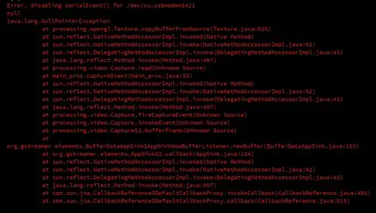

My Processing sketch runs perfectly fine sometimes. Otherwise it will give either this error :
  Error, disabling serialEvent() for /dev/cu.usbmodem1421
  null
Or this one :
Does anyone see anything fishy with the syntax or structure I’m setting up? (I took out all filter functions except the temp -> blur to make debugging easier.)
