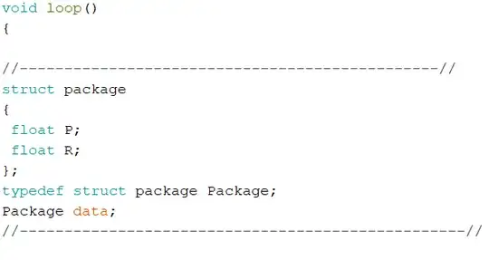

enter image description hereIf you couldn't run this code like me then all you have to do is cut the:" struct package { }; typedef struct package Package; Package data; " And paste it into the "void loop" and it should work fine. P/s: Thank you very much for this helpful video, but hope you will update this in the future ( i guess the update had changed something in the Arduino codes)
