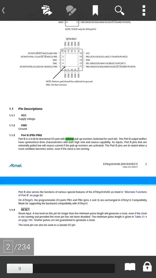

Check the datasheet, probably just search for "internal" or "pullup"
I believe there are little more pins/ports as portB, so they should all have internal pull ups.
