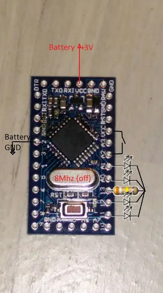

I'm thinking of creating a "small" electronic dice. (I will solder the button a little different though xD)
But there are some concerns on my design:
Powering from a coin-cell
It's a 5V arduino Pro mini, but it should be able to run (per datasheet) on 2.7V to 5.5V, can I just put the 3V of the coin-cell battery on VCC. (I'm aware I'll have to use the internal 8Mhz clock on this voltage though). I won't need the regulator, since the coin-cell will never exceed 5V?
Can I use a I/O as (input/supply) GND?
You can actually use outputs as positive voltage, and you can sink currents. But does that mean I can connect the negative side of the coin-cell to an output, and sink it? This way it should power my arduino's VCC pin through the "digital GND"
Using the reset button
I could use the reset button, but would it still give me "random enough" numbers? Since the seed is reset every time?
(I probably won't use it though, it's placed inconveniently for this project, but I am wondering.)
A crude drawing below:
The fun thing is, polarity of the LED's/segments doesn't matter, since I can change which side is high or low? :) Also, I've only drawn half the LED's/segments. And I know it's better to use a resistor on every pin, but I don't want to make it any more bulky.
(btw, battery GND pin should be pin 4, not pin 2)
aaa
You can use an I/O pin as a supply for another (low power) device, but you should power the Arduino itself from its Vcc and GND pins.
That is correct.
Definitely not. That is a sure-fire way to kill the Arduino.
Also you have a Catch-22 situation. To make the pin conduct to ground you have to set it to output and switch it LOW. How can you do that if the chip is powered off? You need to power the chip on in order to power the chip on. It just can't work.
It's not "better" - it's REQUIRED. With just one resistor and one segment on that segment will get 8x the current compared to having all 8 segments on. You then either get very dim segments with lots on, or smoke from segments when not many are on.

Yes you should be fine with the voltage from a coin cell - though don't expect it to last long!
No you can't use an I/O as ground - they are set to input by default, and even if they weren't, if wouldn't be guaranteed to work, and even if it did happen to work*, it would be horrible. I don't quite understand why you want to do it this way - why not just connect the cell's -ve to the GND pin, right next to the VCC?
It would not be a good idea to use a input pin as they can only sink a maximum of 40mA per pin.
Also, incase any power surges are experienced and it is connected to Vcc if that 5v is exceeded then it could damage your board. It might be a better solution to use the RAW pin even if it does ultimately use more power.
