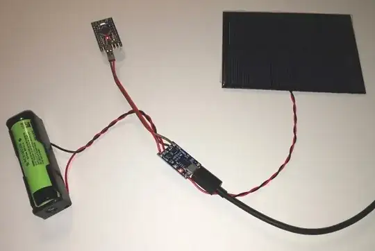

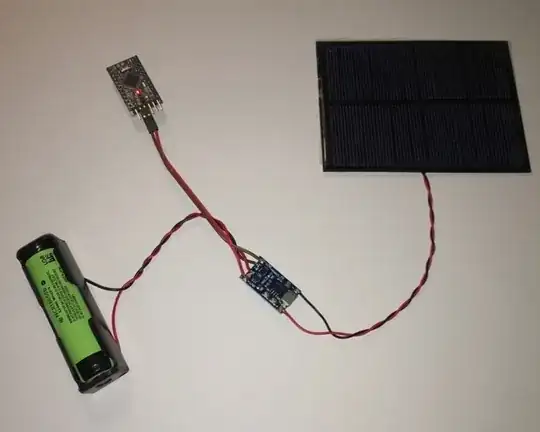

I took some quick snapshots, please excuse the image quality. Charger is in the center, Arduino to the upper left, battery in a holder to the lower left, solar panel to the upper right.
The Arduino has a voltage regulator, but I don't use it in this setup. An explanation why and when to use the regulator is beyond the scope of this question and a matter for another answer.
charger turned off
In the first photo the charger input is only connected to the solar panel, but the panel voltage is low. So the charger is actually off and the Arduino is running off the battery.
charger in charge mode
In the second photo the charger is now connected to a USB power supply. The charger is on and in CC/CV charge mode (as indicated by the red LED of this charger model).

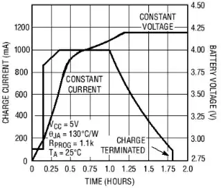

Background info:
The charger switches between CC and CV mode, depending on the level of discharge the battery is in. Particularly, my charger uses CC mode in case the voltage on the battery side is below 4V and CV mode in case the voltage on the battery side is above 4V. The current limit can be configured and the voltage limit is hard coded to around 4.2V, which makes the circuit save for a device like Arduino.
The charger switches between CC and CV mode.
Image source: Nanjing Top Power
Other chargers may have other thresholds, but that doesn't matter as long as it fits your battery type and uses constant current/voltage only. I have no particular recommendation for a charger, but so far have a good impression of the one I used in this answer.
