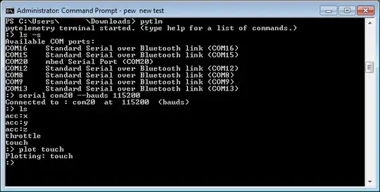

I believe you are looking for something like the Telemetry library.
Full disclaismer : I am the author
It allows you to send string, numbers, arrays, sparse arrays through the serial port for instance. Each sent data has a label, called topic, that is used to identify it.
The Pytelemety command line interface then allows you to connect to the serial port, plot received data in real time, write parameters to reconfigure the arduino from the computer, etc.

Overview of the CLI (Command-Line Interface) enter image description here

Output to file is not implemented yet, although all received data is logged to a file (but this log also contains system information). However, this is an interesting feature, quite straightforward to implement, that I might add in coming days if you are interested.
Central documentation is available here.
