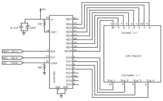

The simple way is to use a MAX7219 chip which does most of the work for you.
You haven't said what LED device you have but an example of wiring it is:
MAX7219 wiring
That chip does the multiplexing for you. I have a detailed description here.
If you don't want to use another chip you could use 12 of your Arduino pins. It's a little tedious because you need to be refreshing the display even while you are doing other things. You could use a timer interrupt for that.
