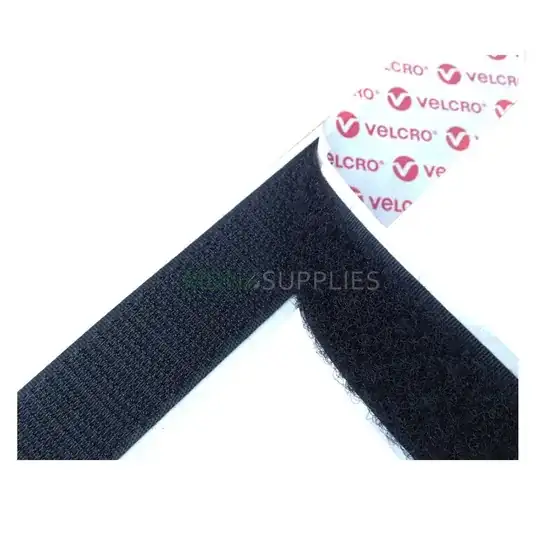

Sticky velcro
A neat solution would be sticky velcro. You can easily attach, detach and re-attach the arduino to the velcro. It looks quite fancy and should hold well.
Again, you should check the specific velcro, it might not last 1000+ times of re-attaching (become loose or smh). But will be a good option overall.
