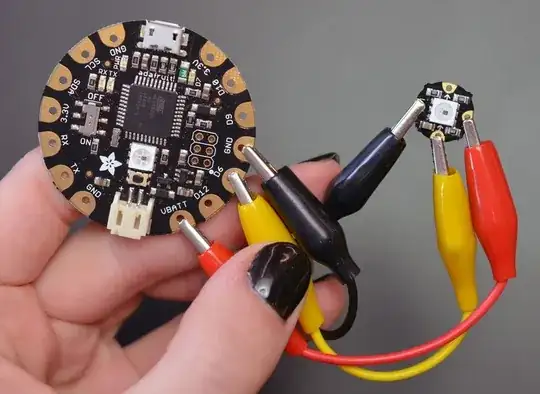

Having said that, I have had a lot of success using alligator clips. You can clip them directly on to wires for LEDs, resistors, capacitors, so long as you make sure they legs/clips don't touch.

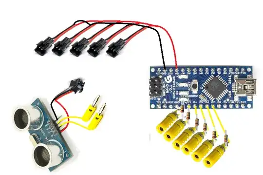

The problem (probably) isn't only because it's too small, wiring can be hard to understand.
I think this might be a solution: enter image description here
It'll cost you some work. But it will get difficult for them to wire it wrongly. Also, I believe coloring them, will make the kids understand it much better. This way they would also be less likely to short out pins etc. Saving you some rangers/arduinos.
Be sure that the power-connectors are not reversible. And you should use a separated supply (with overcurrent protection and what not) and tie the GND to the arduino GND. This way you could even use the supply power for heavier devices.
I'm not a 100% sure on the resistors though, they might interfere with some things you want to make/show.

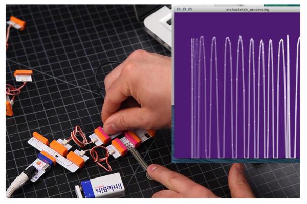

Maybe use something like Littlebits, which uses magnets, but is kind of expensive.
