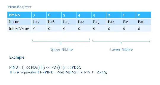

The register PINC is for the inputs to the microcontroller, when one uses staus = digitalRead(A0); they are in effect using a wrapped up version of bitwise math and bit manipulation when simplified to status = PINC & (1 << PC0); thus PINx (x is for the register name ABCD) represents the state of the pin, either HIGH(1, 5V, true) or LOW(0, 0V, False). Borrowing from the below linked tutorial: maxembedded
Another nice description of the input ports in this tutorial.
From the image you see that moving a bit to a position and then bitwise & that with PINx you will have a value returned if there is a 1 in that position.
 PINC      0b00001001
(1 << PC0) 0b00000001
         & __________
status  =  0b00000001
The above shows how you only get the state of the first input and how the 4th input is ignored as it was not needed. Also worth noting PIN is the register description and is not the same as a physical pin that sticks out the IC's body.
