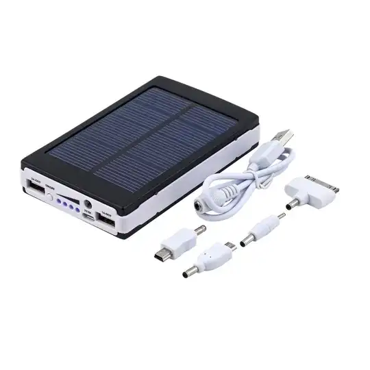

So, I was thinking of adding a solar panel, a charging circuit and a Li-ion battery to my setup, when I discovered these low-cost solar-powered USB power banks on several vendor websites. They make outrageous claims about their charge capacity, that in my experience one has to divide at least by two (20,000 ~= 10,000), but they are pretty rugged and seem appropriate for outdoor installation. The units seem to use a 6V/0.6W (100mA) solar cell that should theoretically be sufficient for charging the battery even if some days are less sunny or shorter.
I wonder if anyone has used one of these as a continuous power supply for an arduino kit, or can inform me about the possible limitations. The idea is not to deal with the power apparatus myself each time I want to assemble a kit.
