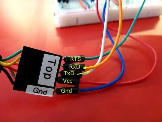

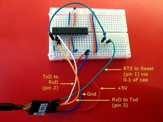

From that page, this is how I hooked up my FTDI cable:
FTDI connections
And a close-up:
Close-up of FTDI
You need RTS, via a 0.1 µF capacitor (in series) in order to trigger a reset.
