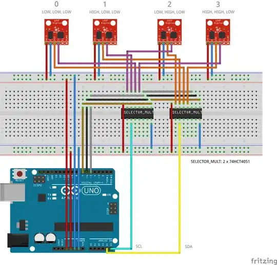

enter image description hereAnybody here have tried connecting multiple MPU9250 into multiplexer. Anyway, I've used the HD74LS151 as the substitute for the 74HC4051 multiplexer. I already tried running the program and just followed how it is connected as it is connected like in the picture. Please see the attached image in here.
Right after running the code I just only got zeros on the output. I hope someone could help me figure out what's going on with my program or the connections of my pins.
And here is the code I used:

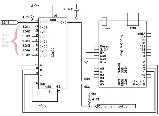

Your concept sounded sensible enough so I gave it a try-out.
Multiplexed I2C
First point is: The master always generates the clock so we don't need to multiplex that. We only need to multiplex the data (SDA).
Code snippet:
// the multiplexer address select lines (A/B/C)
const byte addressA = 6; // low-order bit
const byte addressB = 5;
const byte addressC = 4; // high-order bit
int selectTarget (const byte which)
  // select correct MUX channel
  digitalWrite (addressA, (which & 1) ? HIGH : LOW);  // low-order bit
  digitalWrite (addressB, (which & 2) ? HIGH : LOW);
  digitalWrite (addressC, (which & 4) ? HIGH : LOW);  // high-order bit
  }  // end of readSensor
All you have to do is call selectTarget(n) where n is 0 to 7, and you redirect SDA to the desired chip. I suggest a 4.7k pull-up on the target side so that the line is pulled high when not selected.
I tested it out and it seems to work OK.
The beauty of this setup is that you can multiplex 8 devices (eg. sensors) which happen to have the same I2C address, with only one additional chip. And, you can get 16-channel multiplexers if you want to take this further. Of course, in the code you still have to select the correct I2C address for the chip.
