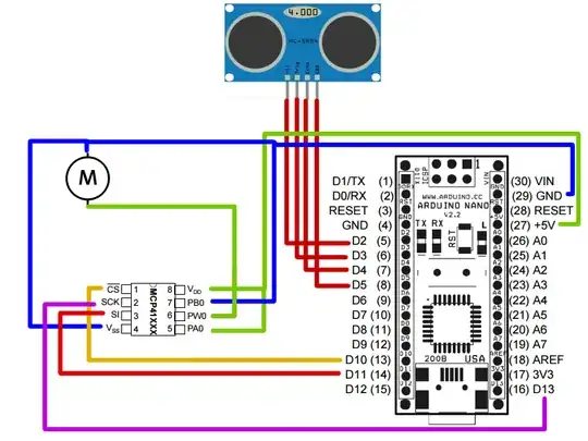

I am a beginner when it comes to electronics, coding and things like that (this is practically the first time I have done anything like this), so when building an application that is supposed to vibrate a vibration motor with a strength based on the distance measurement made by the ultrasonic rangefinder, I bumped up with a problem.
The MCP 41010 digital potentiometer seems to let electricity through only when it is given a SPI.transfer(128). Any other number stops the flow of electricity completely.
I have tried some addresses such as 00, 0x00, 0x01 and 0x04 to replace the 0 and the result was the same. With addresses 0x11 and 0x08 the digital potentiometer didn't react at all.

Digital potentiometers are not a good choice for controlling the speed of a motor. They are designed only for very low current applications - things like setting offset points for op-amps and things like that - things where you would use a small trimmer pot rather than a large power rheostat.
Instead you should be controlling the motor using PWM and a transistor (here is a good tutorial).

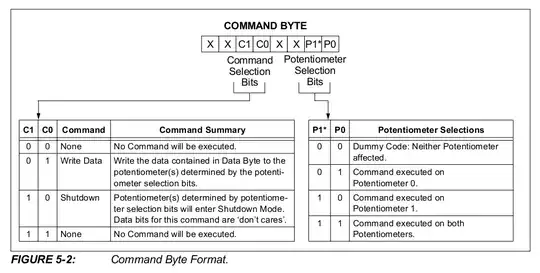

In this case the protocol is made up of two bytes - a command byte and a data byte.
The command byte is made up like this:
As you can see it's in two parts - a command and a potentiometer selector. So to set the resistance of potentiometer 0 you would need to craft a command byte that had the write command and the code for potentiometer 0. That would be 0b00010001 or 0x11 in hex. So your transaction would look like:
