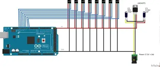

'Schematic' (only showing first 8 sensors connected. The ArduinoMEGA is connected to a computer via a usb cable with disabled power line):
'schematic' (only showing first 8 sensors connected. The ArduinoMEGA is connected to a computer via a usb cable with disabled power line)

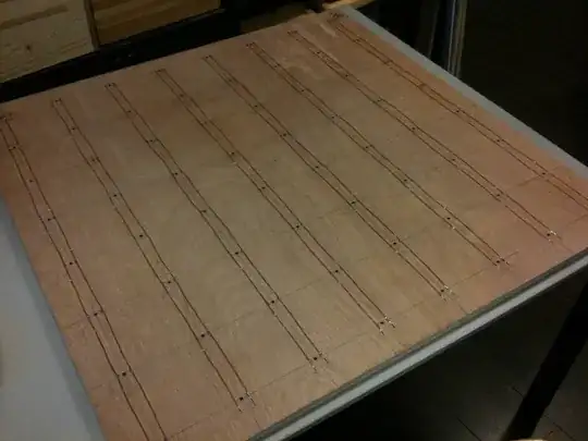

Top-side: the hall effect sensors and Vcc an GND rails: Top: the hall effect sensors and Vcc an GND rails

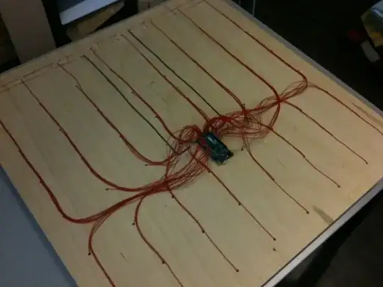

Bottom-side: ArduinoMEGA + the 64 red sensor output lines to the input pins: Bottom: ArduinoMEGA + the 64 red sensor output lines to the input pins

Your schematic indicates a single 1uF capacitor on the output of the voltage regulator, however, there are no capacitors for the sensors. The one capacitor is only for output filtering for the regulator, and will not satisfy any decoupling needs of the sensor.

  1. You have long wires that are basically acting as antennas that will capture any nearby noise.
  2. You have long power lines running parallel to your signal lines which can cause stray inductance which leads to other interesting things. (With the thickness of the plywood separating them, this might not be an issue, but it is something to be aware of).

With that many wires running together into the Mega, there might be cross talk problems.
