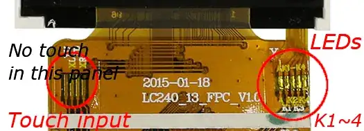

Most of thees cheap Chinese LCD modules have the LED backlight hardwired to Vcc and GND and cannot be controlled.
However, after inspecting the module I have and some similar ones online I found that most have the Back-light LEDs pins available through the LCD panel flex cable. If yours is similar to the one in the picture then you will notice that the main flex cable is for the LCD itself, and there are usually two other flex cables connected to it. The one on the left is for touch panel (if equipped), and the one of the right is for the back light LEDs (sometimes it is connected on the backside of the flex).
In this panel and on mine (a little different from this) they are labeled as K1, K2, K3 and K4 which are mostly the Cathode side of the LED (negative side) and they are exposed as separate pins in the main flex cable, while the Anode is soldered to the main flex cable Vcc plane and cannot be easily accessed without desoldering the LED flex cable.
So in ordered to control the backlight you have to cut the trace on the PCB (not the flex cable) and connect it to a transistor which you control through the Arduino.
  • Double check the polarity in your LCD panel, it could be different from mine.
