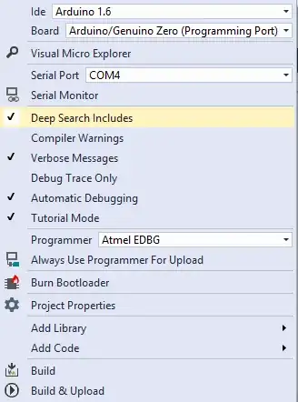

The Visual Micro release yesterday includes automatic "library in library" discovery which means you would no longer need to put all lib #include's in the project_name.ino. (tip: you can switch the "deep search" feature off for each project via the Visual Micro menu. It slows the compile down with large libraries)
