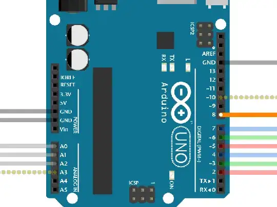

Currently my project looks like this:
My Arduino is connected like this:
And the code I wrote is:

The idea is that a command gets sent from the serial monitor. Based on the command one led on the matrix will turn on. An example of a future command will look similar to this: "#drawPixel_X1_Y2%", hence the part that checks on "#" and "&".
The problem is that the functionality of the serial monitor isn't working with line 14 and 48 of the code. As soon as I remove those lines, the serial monitor works perfectly and I can receive and write to the serial monitor. I have no idea what is causing this.
I was wondering if someone ever faced a similar problem or knows what I am doing wrong right now.
Thank you in advance!

According to Adafruit https://learn.adafruit.com/32x16-32x32-rgb-led-matrix/overview these led matrixes require active scanning. It means that the RGBMatrixPanel will set up some scanning interrupt to refresh the screen periodically.
This can very much interfere with serial receive, as according to Adafruit, the panels require a serious data transmission all the time.
Try the followings:
  • have one byte serial commands, e.g. N for "on" and F for "off" (I know you will need more complex commands, but this is just to verify the theory)
  • remove all debug Serial.printlns (those also consume some time)
So try this:
  if (Serial.available() > 0) {
    char incomingByte = Serial.read();
    if (incomingByte=='N') {
       matrix.drawPixel(0, 0, matrix.Color333(7, 7, 7));
    if (incomingByte=='F') {
       matrix.drawPixel(0, 0, matrix.Color333(0, 0, 0));
