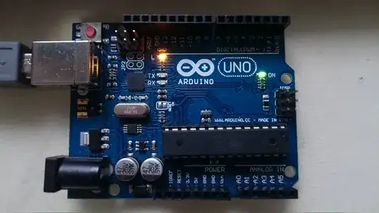

And I have got one more info. When I plug Arduino with USB to my laptop the L led lights. When I press Reset on Arduino nothing happens, it still lights.

Photo of Uno
I will buy USBasp programator is it a good idea?
It's normal that the L-LED is steady on after the USB connection is established. However, after pressing and releasing Reset it should flicker for a second, then go back to on again.

  3. Try reflashing ur bootloader which is a common problem when you see data sync errors.
Yes, buy the USBasp programmer, reflash the bootloader with it, and try uploading code again. A corrupted bootloader very well may be the problem.
