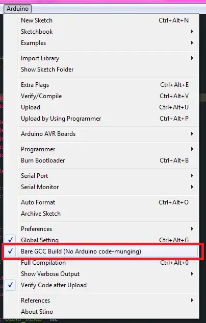

I recently wanted to do exactly this. Since there is no nice way to do so, I wound up writing a patch for the Stino sublime-text arduino plugin to do exactly this. It's subsequently been accepted, so it should be in any up-to-date Stino installs.
This adds a new option to Stino:
Using this mode produces compilation results like the following:
For a Uno:
Binary sketch size: 172 bytes (of a 32256 byte maximum, 0.53 percent).
Estimated memory use: 0 bytes (of a 1024 byte maximum, 0.00 percent).
For a leonardo
Binary sketch size: 240 bytes (of a 28672 byte maximum, 0.84 percent).
Estimated memory use: 0 bytes (of a 2560 byte maximum, 0.00 percent).
Actually programming the leonardo with the above compiled output is probably a bad idea, as it might break the auto-reset functionality, but you could, if you wanted. Hat-tip to mpflaga for noting this in his answer.
Note that the memory reports are actually incorrect, but that's a separate issue.
