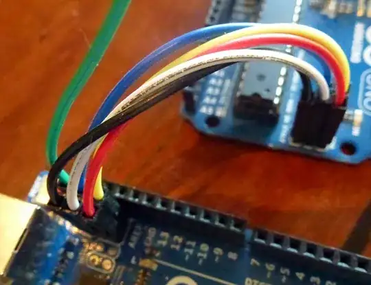

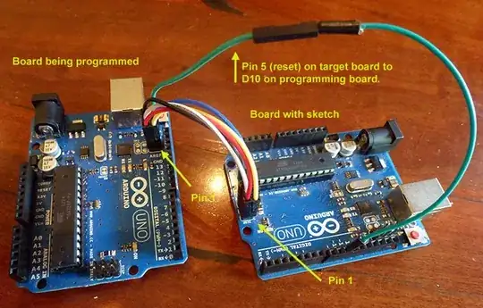

You can use my Chip detector sketch to confirm (using another Arduino to run the sketch) if the target chip is a Atmega16u2 or not, and if so, what fuses etc. are set.
Wiring would be like this:
Connecting to Atmega16u2
Close-up:
Wiring close-up
ICSP header (from above):
ICSP header
