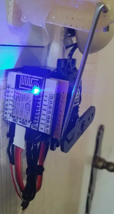

The Robotoic Light Switch
http://hackaday.com/2015/11/06/the-robot-light-switch/

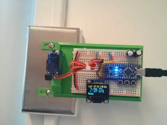

Wifi controlled light switch
https://hackaday.io/project/5141-wifi-controlled-light-switch
