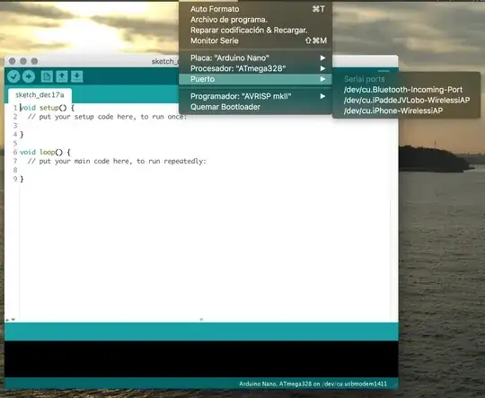

But by the time I connect it to my Macbook Pro (OS X El Capitan 10.11.2) doesn't appear under "Tools -> Port" in Arduino IDE:
I've followed some instructions by other posts here in StackOverflow:
But none of them worked :(

I was be able to solve the issue.
By looking for the serial chip my board has: CH340G I found this blog post:
http://kiguino.moos.io/2014/12/31/how-to-use-arduino-nano-mini-pro-with-CH340G-on-mac-osx-yosemite.html
So I downloaded the signed driver for my chip and now it works :D
Driver: http://kiguino.moos.io/downloads/CH34x_Install.zip
